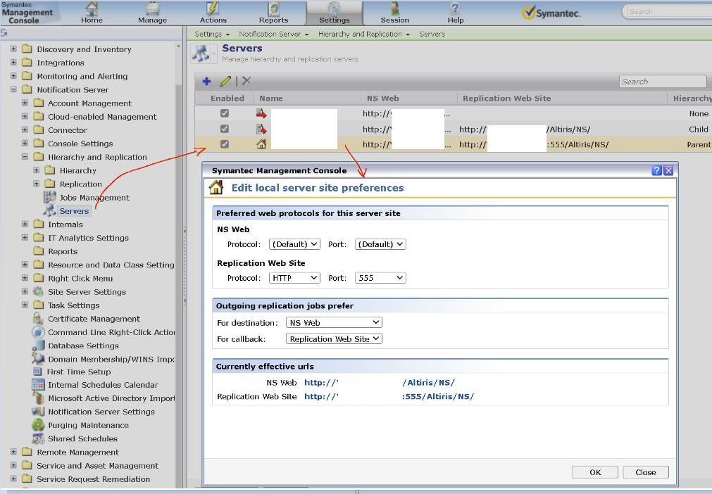

NEW UI in the “Servers” page:
Now it is possible activate “Edit” for local server – new UI with all the binding related settings will appear:
After setup and clicking “OK”, the API will change the Core Settings, but will it be effective – depends on the IIS being able to find out these bindings as available.
