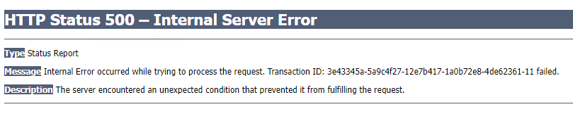

Authentication process failed with HTTP Status 500 - Internal Server Error
Access Gateway's httpd access log shows the following invalid_request message.
GET /affwebservices/public/bctokencontroller?error=invalid_request&error_description=Invalid%20id_token_hint...

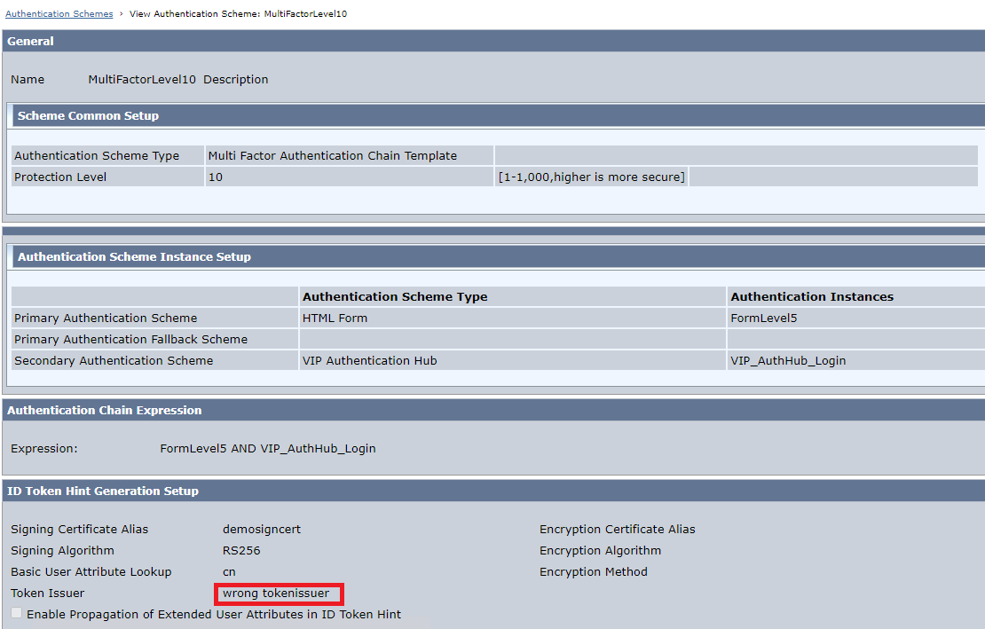

The tokenIssuer in the Multi Factor Authentication scheme doesn't match with the one in VIP Authentication Hub Admin UI.
In SiteMinder AdminUI shows a wrong or empty tokenIssuer.

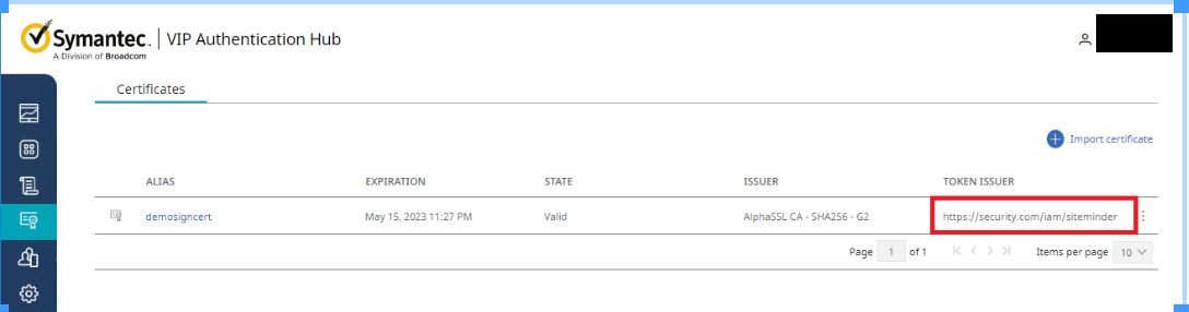

VIP Authentication Hub Admin UI shows the certificate has the correct tokenIssuer.
