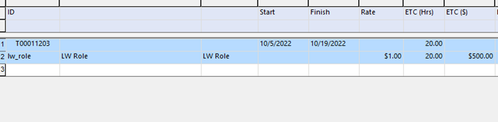

In 16.0.3 and 16.0.3 patch #1, for many scenarios, even though there are rates in the matrix for the resources OWB still shows a Rate of $1
The associated table used to get the rate, nbi_proj_res_rates_and_costs has the correct rates/costs and OWB calculates costs correctly for ETC and Actual Cost when using the field and changing the type from Hours to Costs, the Rate still shows as $1
Clarity also calculates ETC Cost and Allocation Cost correctly.
Rate Matrix Extraction job is run with the first 3 options.
 - Extract Cost and Rate Information for the Scheduler
 - Prepare Rate Matrix Data
 - Update Rate Matrix Data
OWB Example:
Resource: LW Role
You can see the Rate: $1
ETC: 20
Matrix Rate/Cost for this role is $25
ETC ($) Calculates correctly as $500 though the rate is $1
