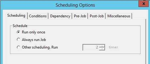

4- In Scheduling options, put “Run only once”:

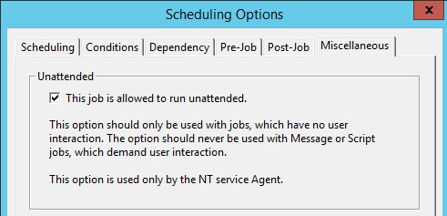

And make sure that “This job is allowed to run unattended” is checked under Miscellaneous tab
