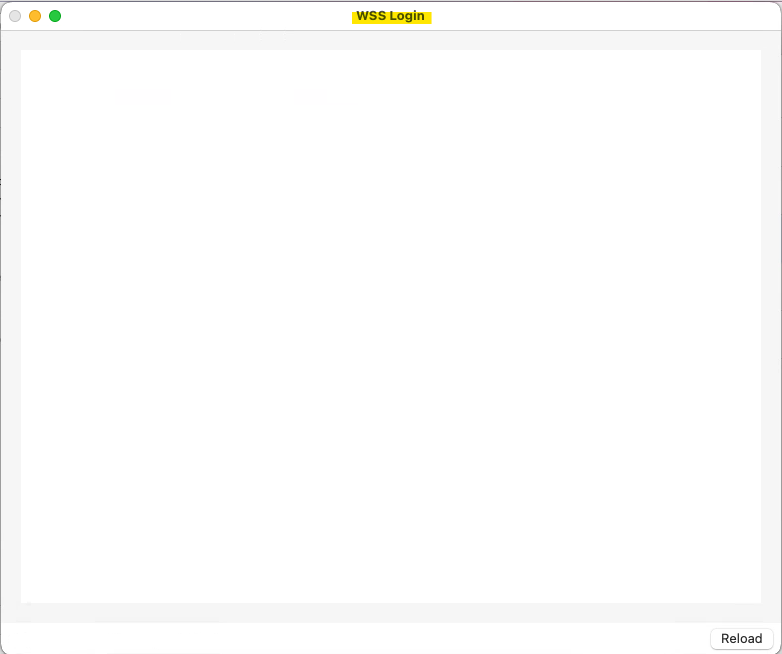

Users on internal network get a popup page without any error message or challenge for credentials as shown below:

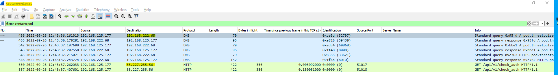

Request to pod.threatpulse.com triggering start of SAML based authentication going out public interface and not in-tunnel interface.

When we bypass these IP addresses, and our DNS server is listening on an RFC1918 IP address, DNS snooping is not happening and we sent request out the public interface instead of tunnel as shown below:
Any DNS server listening on any of these RFC1918 IP address ranges will be bypassed and exempted from snooping. In doing that, IPv6 blocking, domain bypass, and SAML authentication will all be impacted.
After removing the RFC1918 IP addresses from WSS bypass list, the WSS agent DNS snooper picked up the DNS requests for pod.threatpulse.com and saml.threatpulse.net and sent the requests into the tunnel allowing the SAML IDP login page to appear.

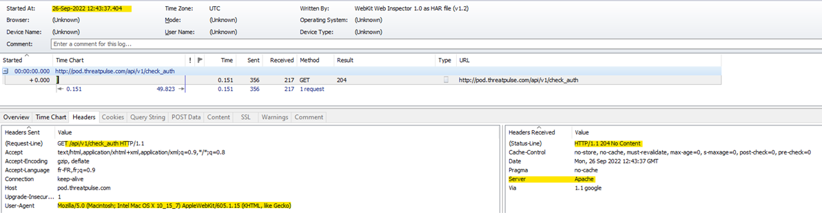

  3. HAR file shows one GET request to pod.threatpulse.com starting the auth process at 14:43:37 but instead of getting a 307 redirect we get a 204 response with no payload.
  4. Debug WSS Agent logs for this session show that DNS request/response bypassed WSS Agent and hence subsequent request was not sent into agent tunnel - causing auth to break.
