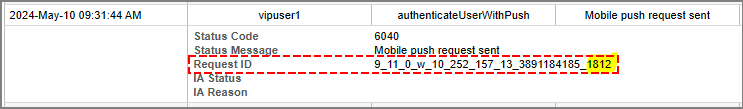

A Request ID is included with every end-user transaction sent to the VIP Cloud by the VIP Enterprise Gateway and can be seen in the VIP Manager end-user transaction reports. The request ID consists of the VIP Enterprise Gateway version, platform, local IP address, and unique identifier. In the request ID below, 9_9_2 is the version, w = Windows (l is Linux), 10_255_1_141 is the local IP address, and 1146892231 is a unique transaction identifier.

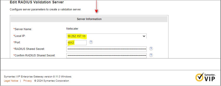

For customers using VIP Enterprise Gateway 9.11 and later the RADIUS validation server port is also appended onto the end of the Request ID. In the example below, the Request ID is 9_11_0_w_10_252_157_13_ 3891184185_1812. The 1812 indicates the request was received from a validation server running on UDP port 1812. This allows administrators to identify the IP address of the VIP Enterprise Gateway server, platform, and the specific RADIUS validation server the transaction was sent from. The second image is a screenshot of the source validation server.
An exported .csv file from a VIP Manager end-user transaction report will include each request ID and can be used to determine active VIP Enterprise Gateway instances for that time frame.

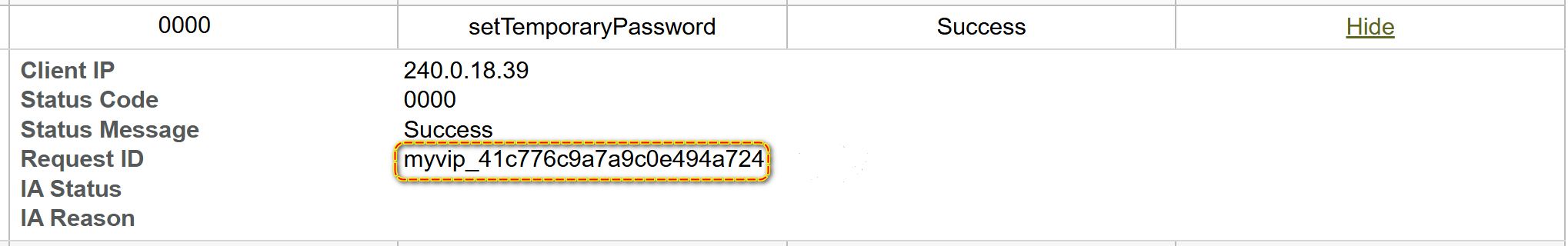

myvip: The transaction was initiated by the VIP My VIP Portal flow:
Note: Logins specific to VIP SSP and My VIP can also be viewed by clicking View Audit Reports, then selecting Self-Service Portal or My VIP.
