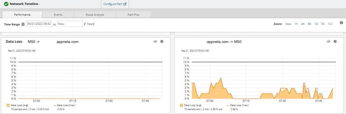

Have setup paths to Azure targets, from local office AppNeta M50 which show consistent data loss inbound to this M50:

Looking at the data loss graph, overlay it to the Voice Loss for the same time frame and if you find that when the data loss occurred, i.e. there was no voice loss and vice-versa such as:
Then this is consistent with a problem in the MTU settings, as per:
TechDocs : AppNeta : Investigating Violation Events - Data Loss
Most likely, an MTU mismatch so take a look at that to see if there is anything incorrect with it.
