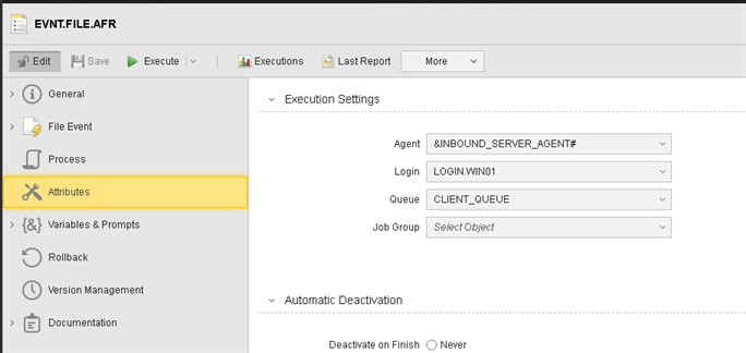

Another example of a non working scenario is the following:

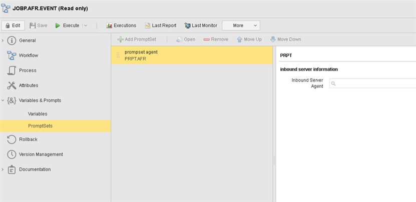

  1. A Workflow has a prompset where the Attribute Agent is set
  2. Inside the Workflow, a Event File inherits the Attribute Agent via the variable from the Prompset

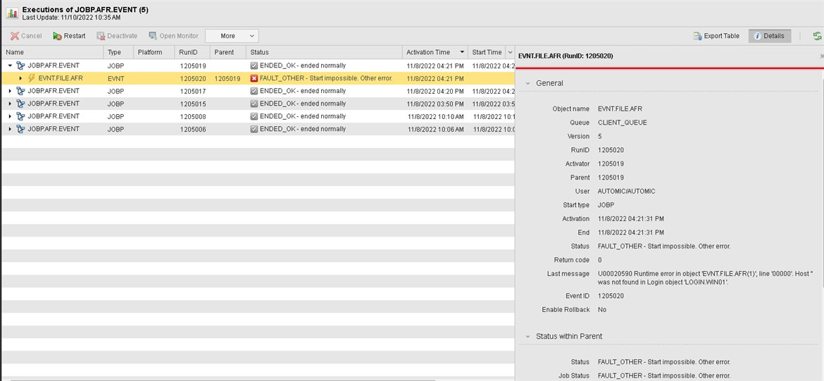

  3. When launched, the Event File execution fails with FAULT_OTHER - Start impossible. Other error.
    If we click on Details - Message:
    U00020590 Runtime error in object 'OBJNAME', line 'LINENR'. Host '' was not found in Login object 'LOGIN_OBJECT_USED'.
