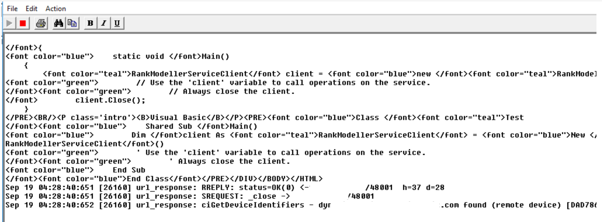

We have de-activated and activated the url_response probe as per suggestion in the article. But after restarting the probe also the alarm is not clearing. But we could see the logs are getting updated in the url_response.log file. Could you provide a solution for this issue.
