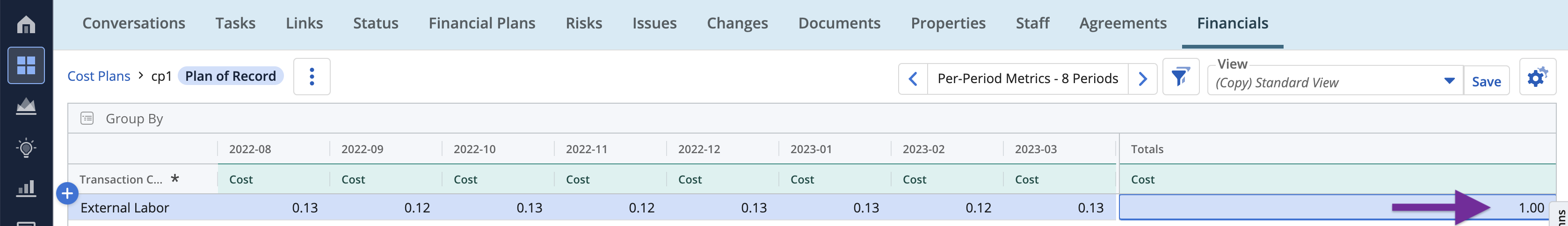

  3. Open financial plan to enter plan details, choose any transaction class, and enter total cost plan value as 1.

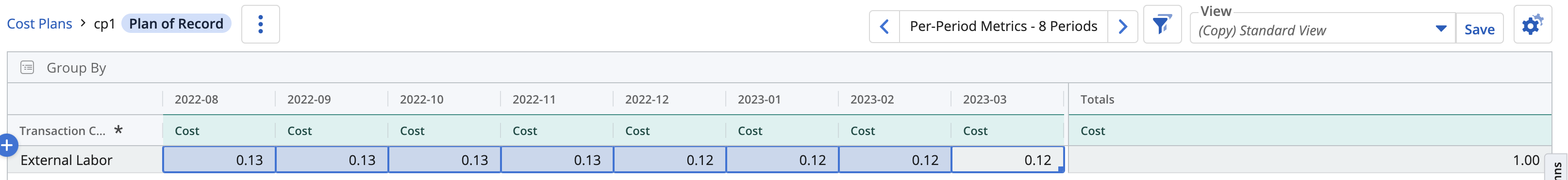

When entering Total cost via UI, even though you see values populated for each month on the UI that's just a calculation done by the application from the cost segment. The XOG IN behavior is working as expected and caused if the cost plan xog data does not include all monthly segments that come between Finish and Start period of the cost plan.
Workaround:
The XOG file would need to modified to ensure all the monthly segments that come between Finish and Start period of the cost plan.
Example ( monthly segments from Start Period: 2022-08 and Finish Period: 2023-02)
     <Cost>
      <segment finish="2022-08-31T00:00:00" start="2022-08-01T00:00:00" value="0.13"/>
      <segment finish="2022-09-30T00:00:00" start="2022-09-01T00:00:00" value="0.13"/>
      <segment finish="2022-10-31T00:00:00" start="2022-10-01T00:00:00" value="0.13"/>
      <segment finish="2022-11-30T00:00:00" start="2022-11-01T00:00:00" value="0.13"/>
      <segment finish="2022-12-31T00:00:00" start="2022-12-01T00:00:00" value="0.12"/>
      <segment finish="2023-01-31T00:00:00" start="2023-01-01T00:00:00" value="0.12"/>
      <segment finish="2023-02-28T00:00:00" start="2023-02-01T00:00:00" value="0.12"/>
      <segment finish="2023-03-31T00:00:00" start="2023-03-01T00:00:00" value="0.12"/>
     </Cost>
