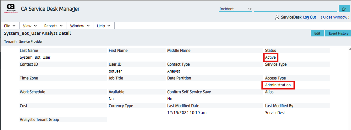

The backend security for the chatbot user "System_Bot_User" was not configured correctly, and the status of "Open" was disabled for Incidents, through existing config and through customisations.
Set the chatbot user "System_Bot_User" to use the Administrator access type and have it set to active.  After this the status of "Open" should be enabled for Incidents

In a given scenario where the chatbot user "System_Bot_User" is rendered inactive, it will prevent the Aria chat to transfer to an analyst, with this message appearing in the collabMS.log:

Further, if the chatbot user is modified in its permissions or active state, SDM xFlow services must be cycled to see the updated changes.
