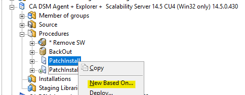

1- In DSM Explorer, go in Software/Software Package Library
Expand the CU package (ex: CA DSM Agent + Explorer +  Scalability Server 14.5 CU4 (Win32 only) 14.5.0.430)
In Procedures, right click on PatchInstall procedure and select New Based On...
2- Give a new name (ex: PatchInstall + INSTALLAGAIN + OVERRIDE)
3- In Embedded File, add /INSTALLAGAIN /OVERRIDE in the parameters list :
4- Click OK.
This new procedure could be sent to the machines to apply again CU* patch and install all files included in CU* patch
