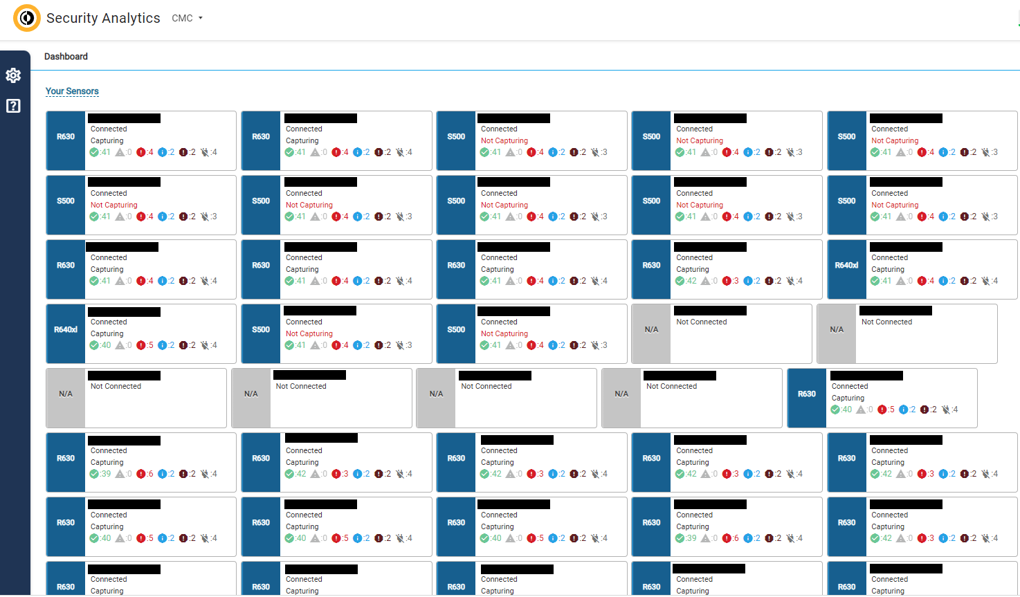

When adding sensors to the central manager, it seems that after about 60 or more are added, they never connect.  They show as "Not Connected"
The Central Manager opevpn network mask was configured as 255.255.255.0   The way openvpn works by default is that for every connection between the sensor and the CM, it takes up 4 IP addresses.  A subnet mask of 255.255.255.0 is the default configuration.  That is 255 addresses, but broadcast takes one of them, so 254.  Divided by 4, that is 63.  In the CMC configuration, if you have more than 63 sensors, they will not be able to connect.  The tunnel is created, but there is no connection.
