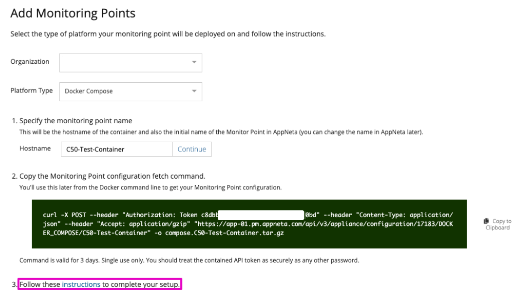

1.  During the container installation after using curl to download the Tar file, you uncompress the file and will proceed to run the setup file.  (Step 3 & 4 in the image below).
The complete installation instructions direct you to:  https://docs.appneta.com/docker
