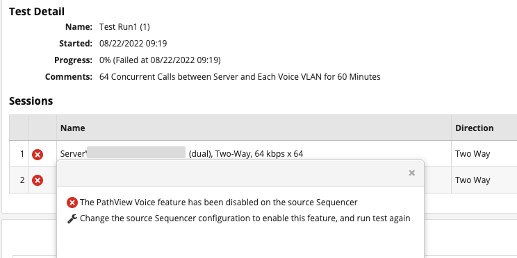

When trying to run a voice test on AppNeta it fails with the following error:
   The Path View Voice feature has been disabled on the source Sequencer
   Change the source Sequencer configuration to enable this feature, and run test again
