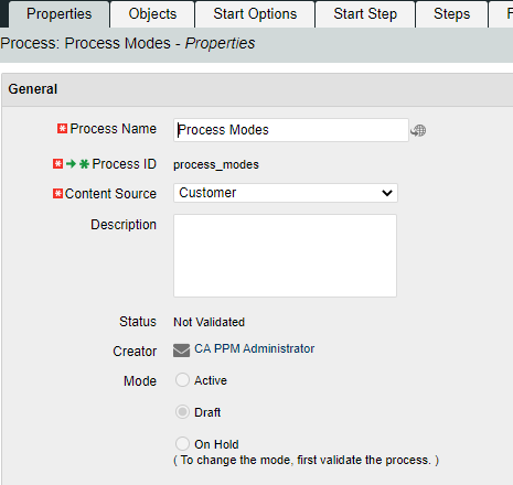

A process can be set to Active, Draft, or On Hold mode. What do each of these modes do to the process?
A process definition can be in the following Mode:
Draft
  • A process definition in Draft mode can be edited and deleted.
  • Process instances cannot be started from a process definition in Draft mode.
  • A process definition must be in Validated status before it can be switched to Active or On-Hold mode.
On Hold
  • A process definition in On Hold mode cannot be edited. It can be deleted if there are no active process instances of this process definition.
  • Process instances cannot be started from a process definition in On Hold mode. However, existing running process instances of this process definition will continue to run until they are canceled or completed.
  • A process definition must be in Validated status before it can be switched to Active mode.
  • A process definition must not have process instances before it can be switched to Draft mode.
Active
  • A process definition in Active mode cannot be edited. It can be deleted if there are no active process instances of this process definition.
  • Process instances can be started from a process definition in Active mode.
  • Only process definitions in Validated status can be in Active mode.
  • Active process definitions having process instances cannot be switched to "Draft" mode. Process instances must be cancelled and/or deleted before the process definition can be switched to "Draft" mode.
