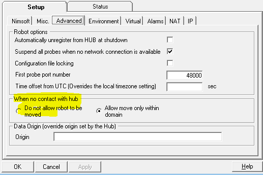

Other 2 options related to robot failover are the following:
With the option below enabled the robot won't be moved at all:
And unchecking the box below avoids the robot to look for any other available temporary hub (if the second is not available)
