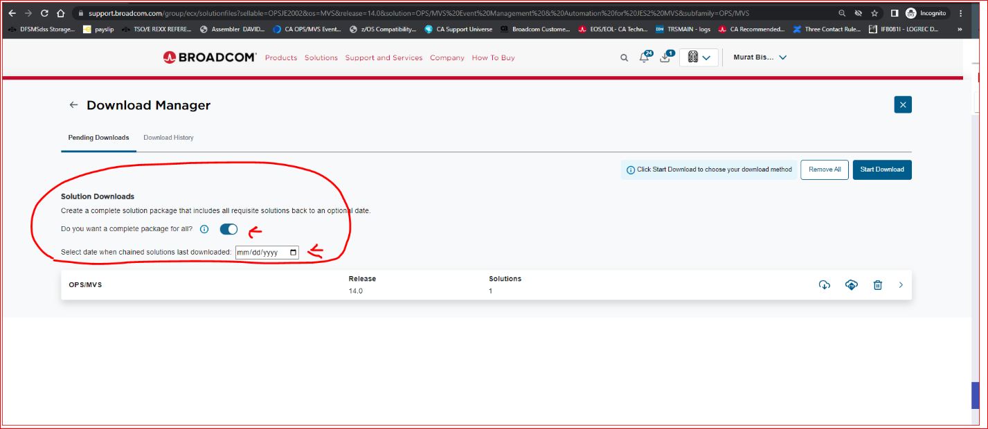

On a checkout phase, there is an option to build a PTF package with prereqs with automatically include all prereqs for selected PTF/PTFs.
Here is an example. Let's say PTF LU08399 needs to be applied and during APPLY check there are some expectations that point to missing prereqs because this fix was RECEIVED and attempted to be APPLIED as a stand-alone fix. To avoid those RC12 expectations on the checkout stage of downloading LU08399 PTF the toggle "Do you want a complete package for all" need to be used and as a result zip file will be generated with LU08399 and all prereqs.
The second option highlighted on below screenshot allows generating a zip with all PTFs that were published by the chosen date. This option is more useful in case of APPLing maintenance after clean install was, either complete or up to a certain date.

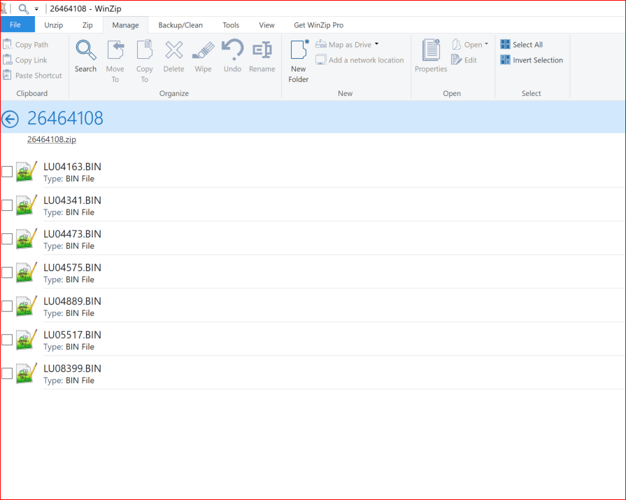

The output zip file contains all prereqs and chooses PTF, see screenshot below.
