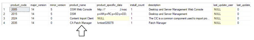

Execute the below query and check if there is a registration entry for patch manager is available as shown in below picture.
If there is no row present for CA Patch Manager. Then please run the below query to add.
