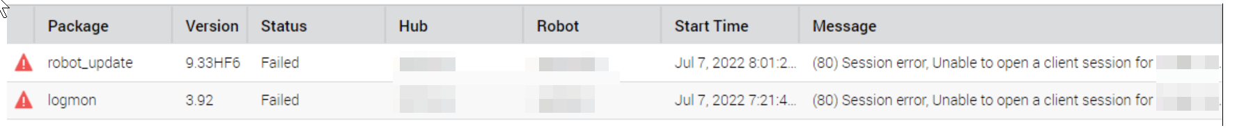

Deploying any probe or package either via IM or AC to some robots fails. Additionally there is a communication error when trying to open any probe configure at one of these robots.

Problem 1:
Viewing either the distsrv or hub log shows the IP address for the robot is different than the IP address shown for the robot in the IM console.
