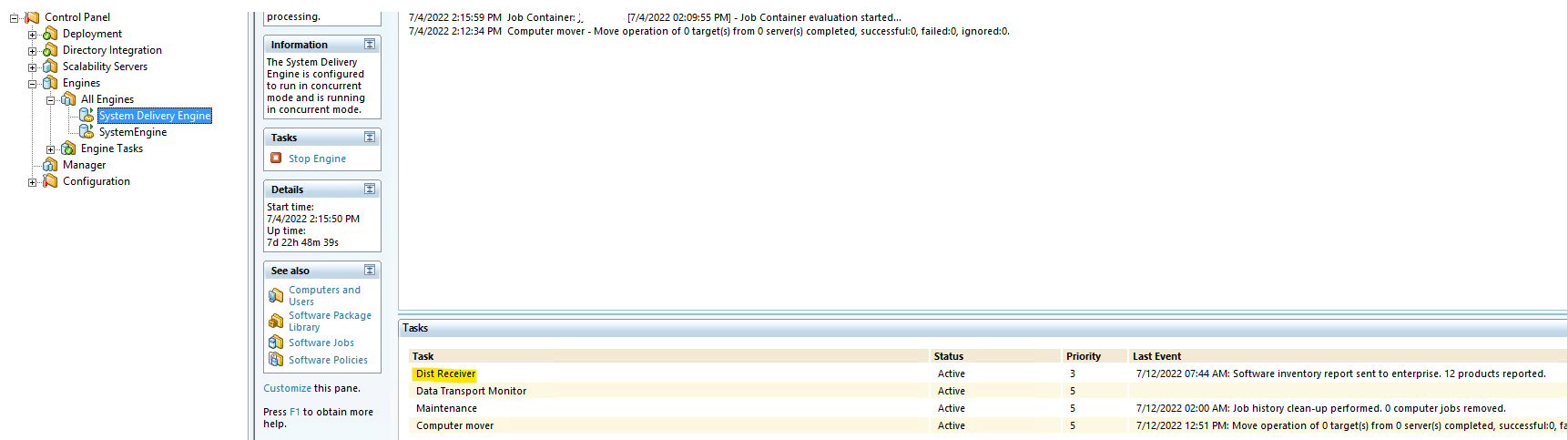

In System Delivery Engine, "Dist Receiver" Task is often executed and takes several minutes to complete.
This is blocking the building and evaluation of SD Job Containers and put the tasks in Differed status.

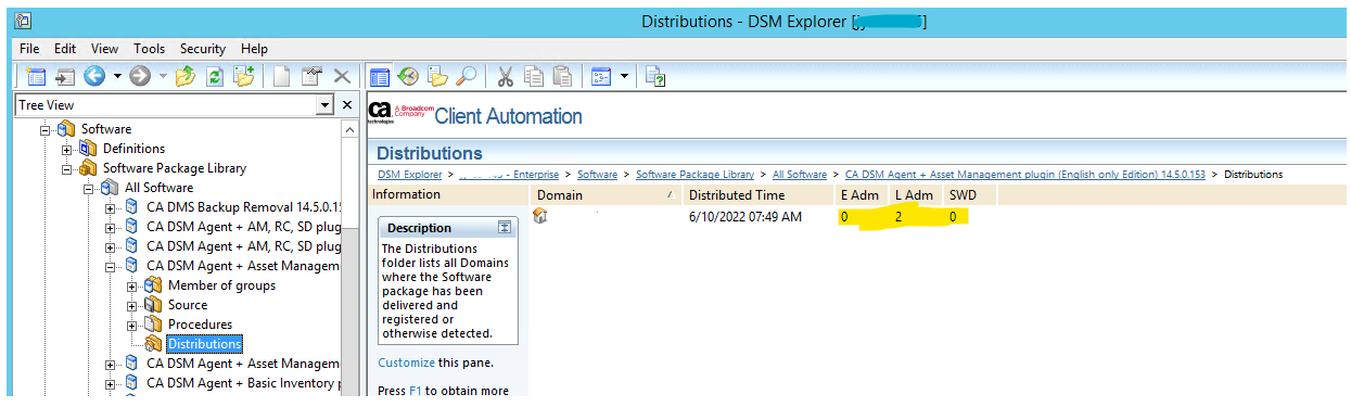

Asset reporting is used to report the 3 numbers which appear in distributions folder of the SD Package :
E Adm : number installation made from Enterprise Server
L Adm : number installation made from Domain Server
SWD : number of detected installation
