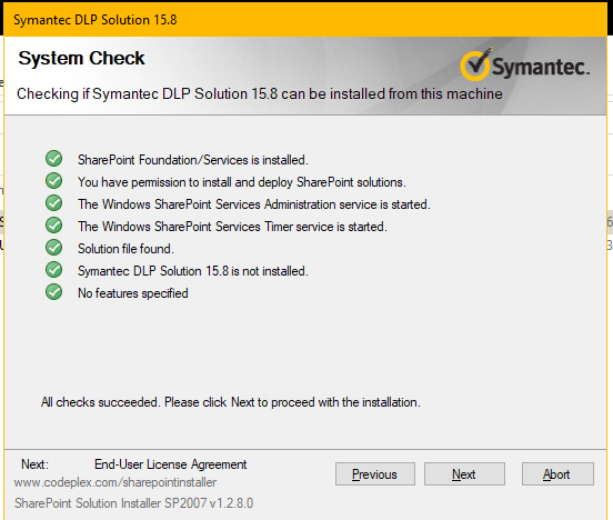

 Customer was unable to install the SharePoint solution due to a database connectivity issue from SharePoint.
Step 1:- Installing the solution we see this error.
Step 2 :-  We see the solution was partially deployed , as we see globally deployed status is missing.
Step 3:- We try to retract the  solution immediately but it does not uninstall/retract
Step 4:- Tried to retract , we see the following error.
Step 5:- Rebooted the server  and ran the solution setup file to remove it .
Step 6:- Removed the solution successfully.
Step 7:-  Reinstalled the solution with no errors
