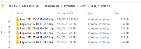

When the scheduled task "NS.NS Log Archive Schedule.{4754ff9c-911b-4d67-9eb0-4d530fb456ab}" executes at 05:00 AM, it will archive all available NS logs that are older than 1 day and remove them from the folder "C:\ProgramData\Symantec\SMP\Logs" so there will be no duplicate logs remaining for the next day's Archiving logs task execution:
All daily archived logs will be stored in the "C:\ProgramData\Symantec\SMP\Logs\Archive" folder, and for example if there are 200 log files with each being 2mb in size, then their zipped summary size will be ~44mb.

Note: After 1 year there will be a lot of archived log files on the NS, so you should manually delete any outdated archived logs from the "C:\ProgramData\Symantec\SMP\Logs\Archive" location. The NS doesn't have functionality to purge outdated archived NS log files.
