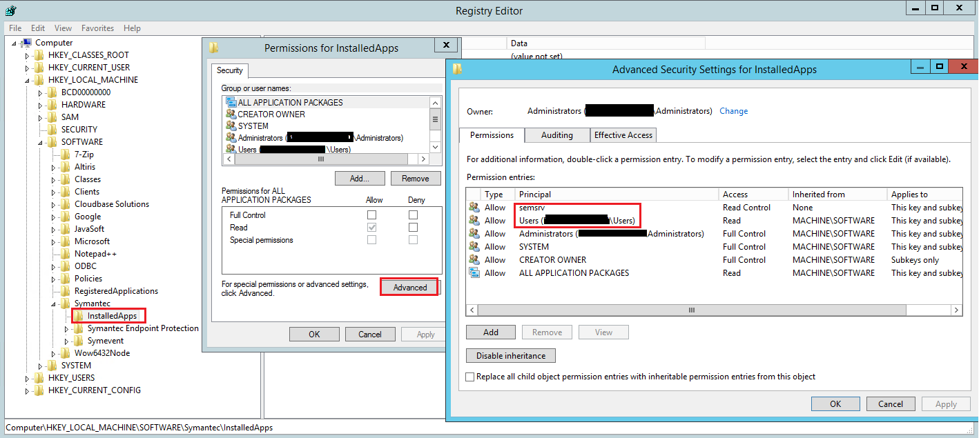

Missing permission on registry key 'HKEY_LOCAL_MACHINE\SOFTWARE\Symantec\InstalledApps'
We can get this issue if 'semsvc.exe' cannot read the registry to detect if SEP is installed. Verify and add the permissions for this registry key as follows:
  • Right click on registry 'HKEY_LOCAL_MACHINE\SOFTWARE\Symantec\InstalledApps' and click Permissions...
  • Click on 'Advanced' tab.
  • Add Read permission for 'SEPM_Server_Name\Users' and 'nt service\semsrv'
Reference screenshot:
