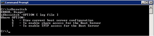

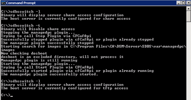

  1. Make sure that the Boot server is configured for TFTP Access
    • This can be checked by issuing the 'sdbsswitch' command
    • run sdbsswitch -L, if the Boot server is configured for share access then change this to TFTP using the command 'sdbsswitch -t'

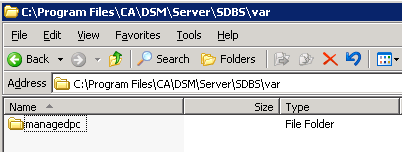

    • The ManagedPC directory is the starting directory of the OS image store.
    • The default location is "%Program Files%\CA\DSM\Server\SDBS\var\managedpc'.
    • The Complete ManagedPC directory must be moved to the new location

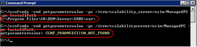

    • Only one of these commands needs to be run dependent on the version of ITCM installed. To determine which command is required run the following 2 Commands:
      ccnfcmda -cmd getparametervalue -ps /itrm/scalability_server/osim/ManagedPC -pn InstallPath
      and
      ccnfcmda -cmd getparametervalue -ps /itrm/scalabilityserver/osim/ManagedPC -pn InstallPath
      One of the commands will return the current value in the comstore and the other will return getparametervalue: CCNF_PARAMSECTION_NOT_FOUND
      The above command that returns the current value contains the correct value for -ps on that server.
      If ManagedPC is moved for example to E:\osim\ManagedPC\ the value for <NewPath> should be set to E:\osim\
      In this example the command should be: ccnfcmda -cmd setparametervalue -ps/itrm/scalability_server/osim/ManagedPC -pn InstallPath -v "E:\OSIM\"

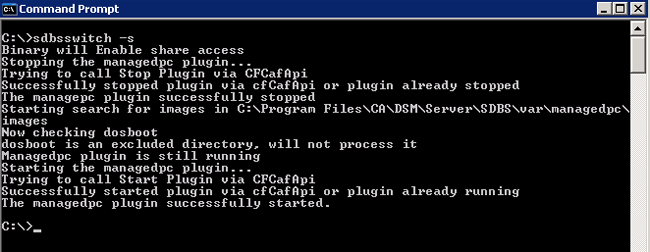

  6. Reconfigure the boot server for share access if this was the original configuration using the command 'sdbsswitch -s'.
