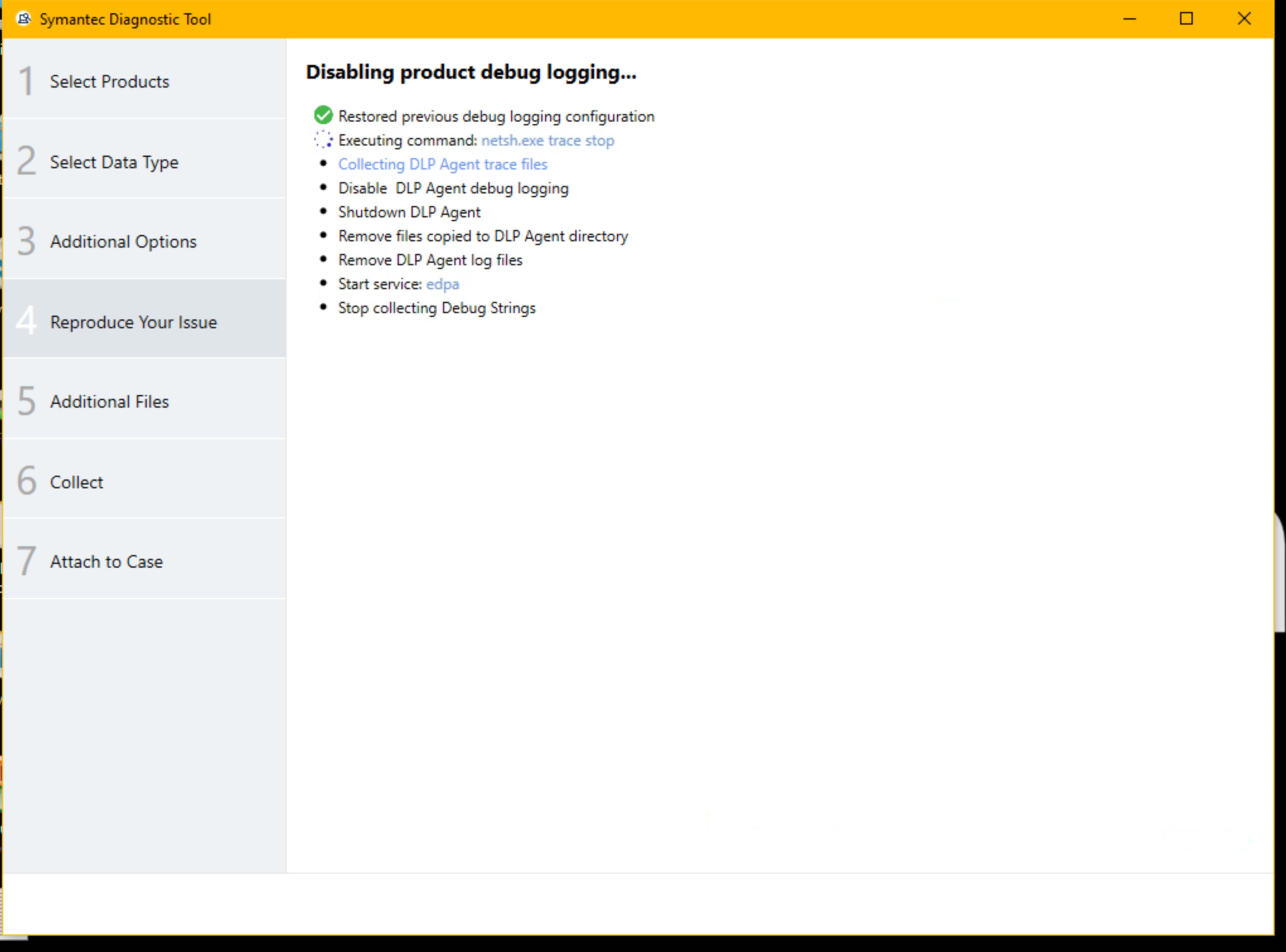

Step 6:-  repro the issue  you are facing  FIRST   and then only click Next
Step 7 :- Once the issue is reproduced it will bring the setting back to INFO level
Step 8:-  Collect the data
