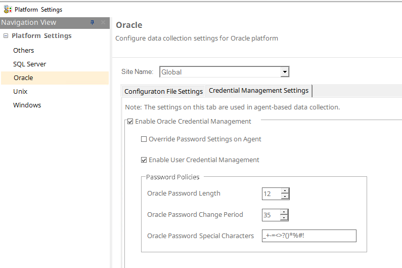

  5. Verify that the "Configure Platform Settings" in Deployment View in the Oracle page under "Credential Management Settings" are enabled.
