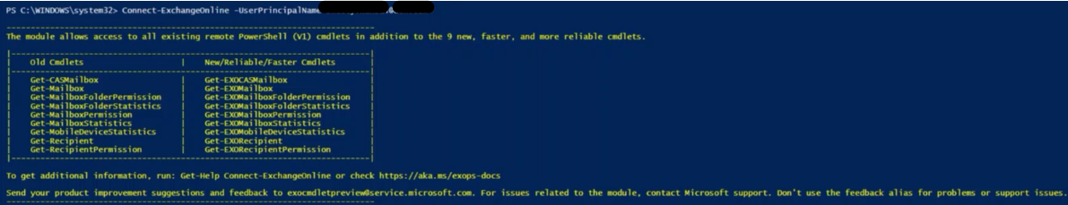

Exchange administrators using Powershell to modify O365 Outlook settings via Powershell fail to connect the exchange server when WSS agent is active on systems.
Exchange administrators report following "Connecting to remote server outlook.office365.com failed" error using powershell commandlets:
