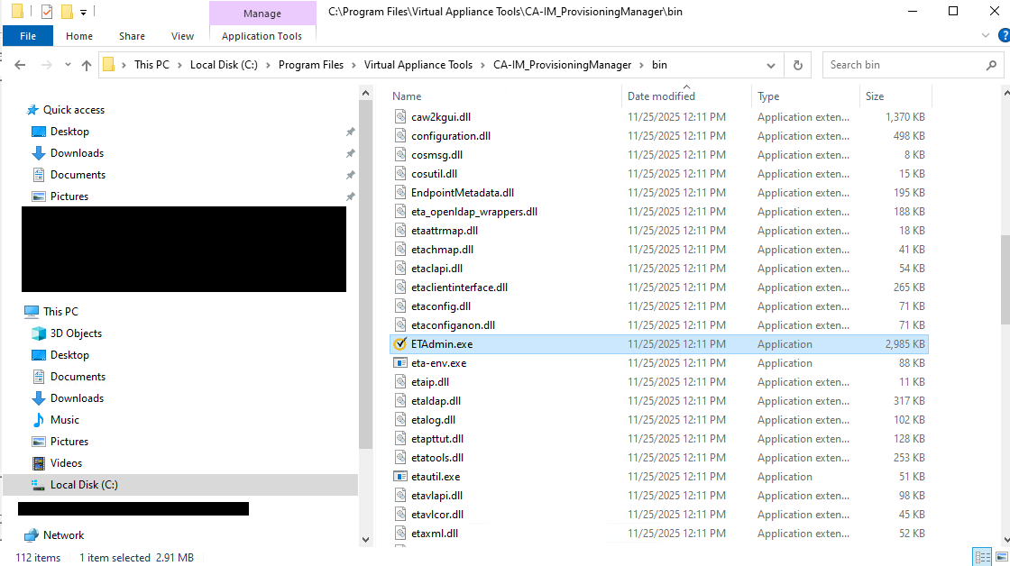

Please don't use Provisioning Manager Setup, but download the latest Remote Tools media and run VirtualApplianceTools.exe. If you click the 'hamburger' menu on the top left of the vApp dashboard and select "External Tools" you will see the instructions.
When you run VirtualApplianceTools.exe it will prompt you to entry vApp ip/host and it should install and configure Provisioning Manager correctly.
Just run the Provisioning Manager, i.e. ETAAdmin.exe, under Provisioning Manager's bin directory.
