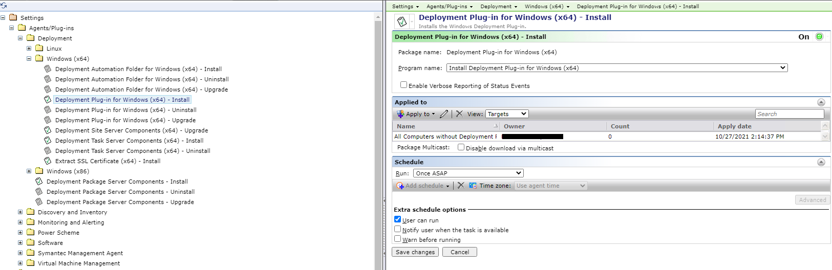

Install the DS Agent plugin on computers before capturing an image:
1. Go to Settings>All Settings>Agent/Plug-ins>Deployment>Windows(x64) and either enable or target this plug-in to the machine that you are using to capture your image.
2. and after the DSAgent plug-in is installed then capture the image again and see if the issue persists or not.
