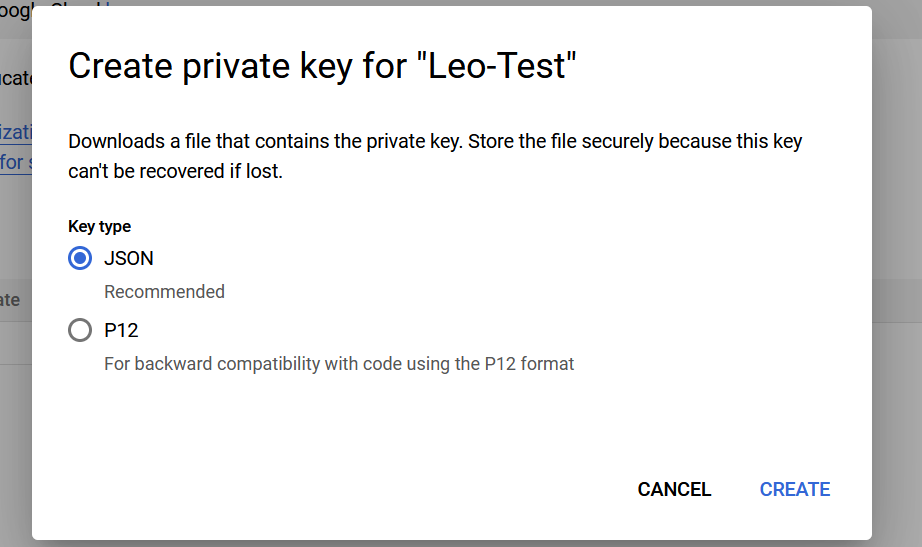

After generating key file from Google side

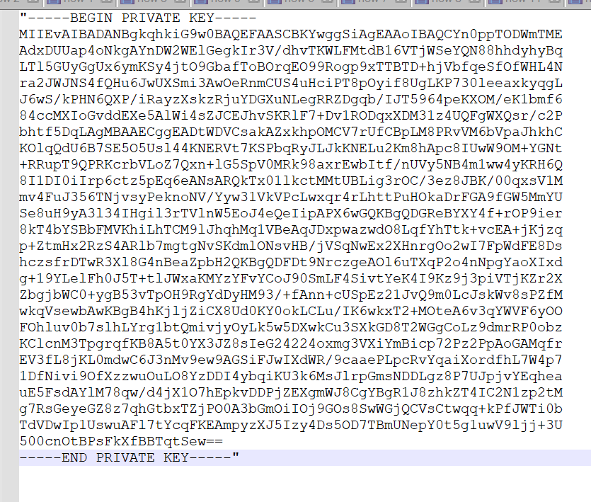

Instead, copy the private key (PEM format) from generated file into editor and delete all end of line signs /n :
Please delete text -----BEGIN PRIVATE KEY----- and -----END PRIVATE KEY-----
So you'll get clear key that you can use to acquiring G Suite endpoint.
