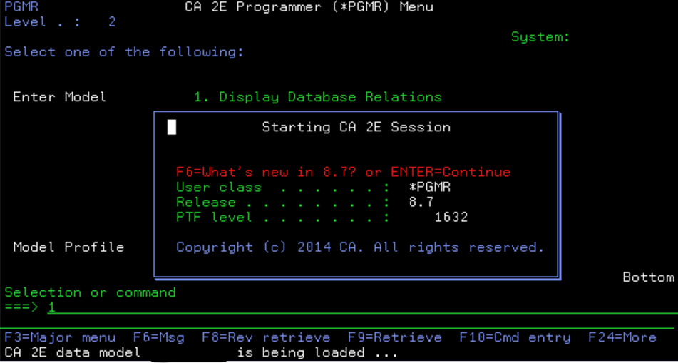

When the programmers run the command to start the application it never gets to the point of seeing a menu.
We've let it run for quite a while but nothing happens
This happened after we had a major system outage and the system had to be restored.
Release : 8.7
Component : CA 2E
Hangs in CA 2E data model xxxxxxx is being loaded...

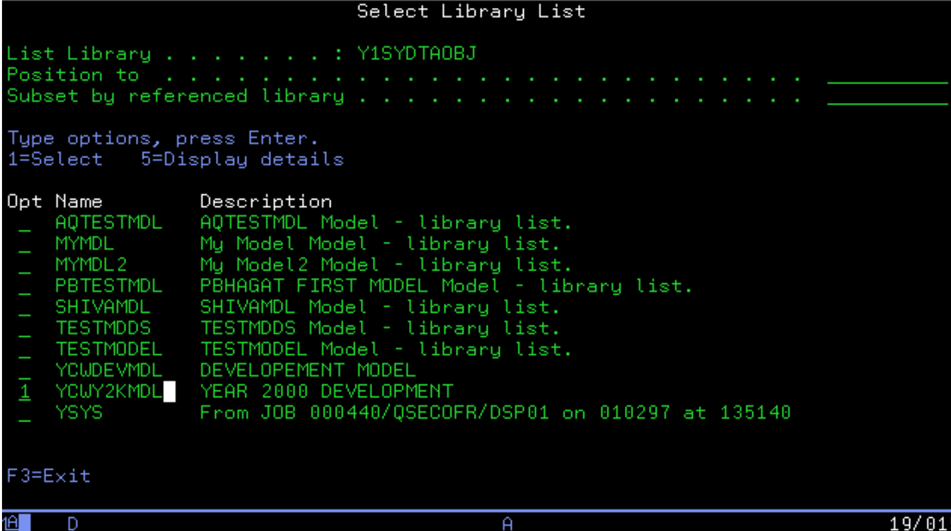

- Set the library list path for the model (customer should know how to perform this)

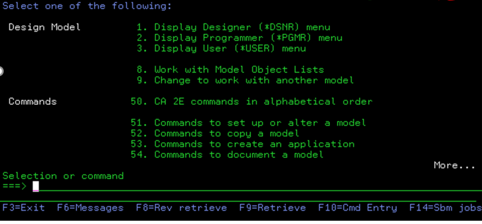

- From the command line, run the command YDLTOBJTBL to delete the Object table and object memory which is allocated at run time
- Maybe the object table space has been corrupted causing the user Model not to load
- After this command was run, when you try to reenter the model, the object table space is rebuilt and Model will load successfully
-This fixes the issue customer facing
