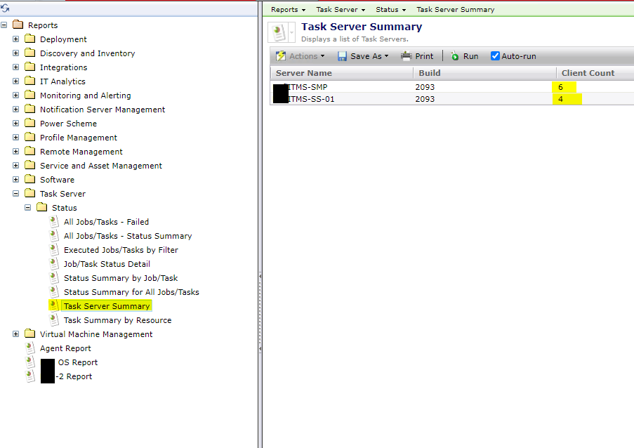

Also, if you want to have an idea of what computers are registered to what Task Server, there is a report that you can use that shows your Task Server(s) and how many clients it has registered. If you double-click on the "client count", it will drill-down to the list of machines.
Go to Reports>Task Server>Status>Task Server Summary
https://api-broadcom-ca.wolkenservicedesk.com/attachment/get_attachment_content?uniqueFileId=y3Ru4/Z859RDhBDFqfD0XA==
