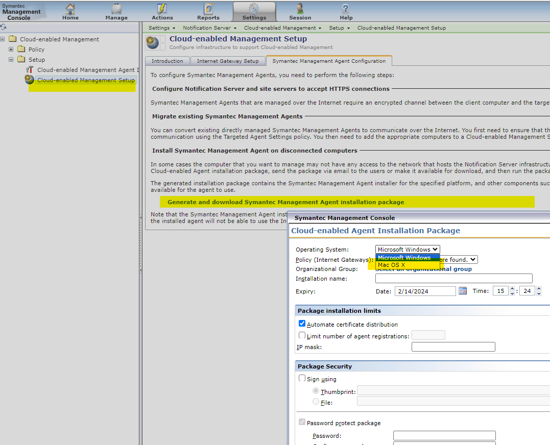

Confirmed that CEM (Cloud-Enabled Management) was being used and the CEM Agent Installation Package had become corrupted, and the corrupted package had only been used on MacOS 12.3 machines.
Re-created the CEM Agent Installation Package in the SMP Console found under:
Settings > Notification Server > Cloud-enabled Management > Setup > Cloud-enabled Management Setup > Symantec Management Agent Configuration tab
