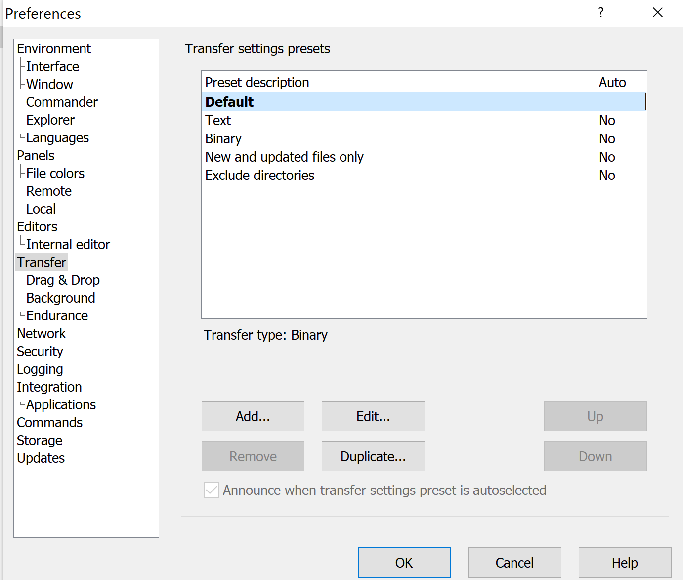

The tool used to transfer the file to the Linux/Unix server wrongly selected non-binary mode while transferring the file.
While transferring file to Unix/Linux server please make sure the Transfer mode is selected as binary instead of automatic/text.
Example below shows configuration changes can be done for WinSCP
  • Navigate to Options -> Preference
  • Within Preferences -> Transfer
  • Edit Default and set Transfer mode to  Binary
