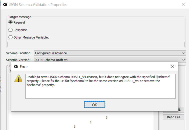

JSON Schema validation assertion fails with an error :
"Unable to save: JSON Schema DRAFT_V4 chosen, but it does not agree with the specified '$schema' property. Please fix the uri for '$schema' to be the same version as DRAFT_V4 or remove the '$schema' property."

Please put your schema below as input and choose V4 version
https://www.jsonschemavalidator.net/
Use the resulting schema and compare if it changed things. In the JSON documentation, below:
https://json-schema.org/understanding-json-schema/structuring.html#id
It says "In Draft 4, $id is just id (without the dollar sign)." And You can set the base URI by using the $id keyword at the root of the schema. The value of $id is a URI-reference without a fragment that resolves against the Retrieval URI.
So replace "id" with "$id" in your schema document, add # at the end of the URI like below and it should work:
