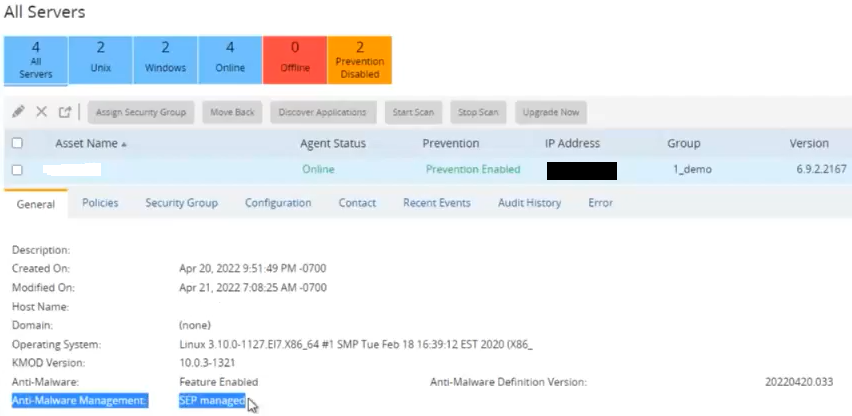

Asset Dual Management Mode
Question |
How can you tell if a Linux Asset is using Dual Mode in the UMC? |
Answer |
Dual Managed (SEP + DCS) DCS Managed |
Note: If you install the DCS Agent first, then it will report to the SEPM if you install SEP afterward. If you install the DCS Agent last, then it will report to the UMC.
