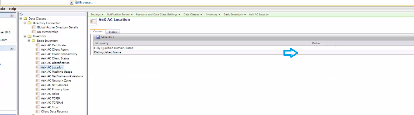

Some managed computers in the ITMS (IT Management Suite) environment are failing to report their Distinguished Name (DN) during Basic Inventory. In the Resource Manager or reports, the AeX AC Location - Distinguished Name field appears empty, even though the computer is joined to an Active Directory domain.

Validation:  After the agent is upgraded, right-click the Agent icon in the system tray and select Send Basic Inventory.
  • Check the logs to ensure the 0x80004005 error no longer appears.
  • In the Console, go to Manage > Computers, right-click the device, and select Resource Manager > Inventory to confirm the Distinguished Name field is now populated.
