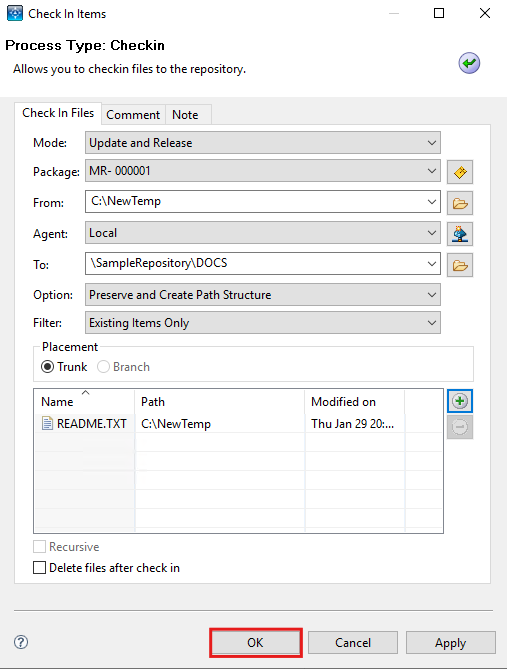

When checking out a file, Harvest keeps track of the user who performed the check out and the computer and folder name to which the file was deployed. The easiest way to see this information is using the Check In process in Workbench. For example:
If a situation arises where the client machine has crashed or has been reimaged, or the user checking in the file has left the company or is on vacation, resolving the corresponding "R" tag can be challenging.
The easiest way to resolve this type of situation is to perform a "Delete Version" process on the "R"-tagged version. At that point a new user can check out the file make the needed changes and check it in.

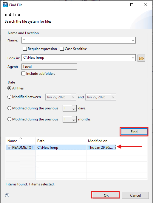

If the file changes are accessible by another user, and the file simply needs to be checked in by a different user or from a different location, the way to do this is to:
