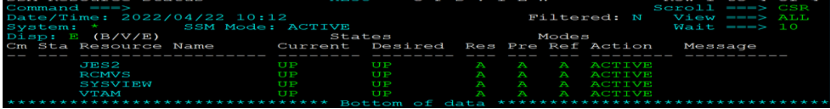

1. Go to option =4.11.2 in OPSVIEW:

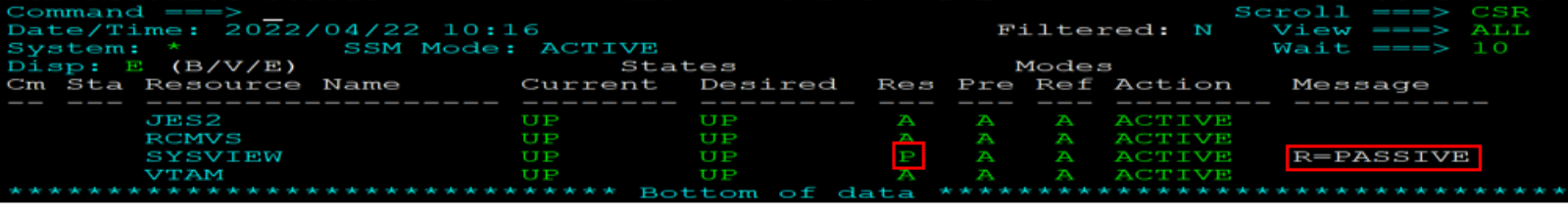

2. As an example, to set the SYSVIEW processing mode to Passive, tab over to the "Res" column for the SYSVIEW entry and change "A" (active) to "P" (passive) and press Enter. The processing mode will be set to PASSIVE:
Now SYSVIEW can be stopped and started at will without SSM performing any automated control of the resource.
To place SYSVIEW back under SSM control, simply repeat steps 1 and 2, but this time set "P" back to "A" under the "Res" column and press Enter. SYSVIEW will again be placed under SSM control as before:
