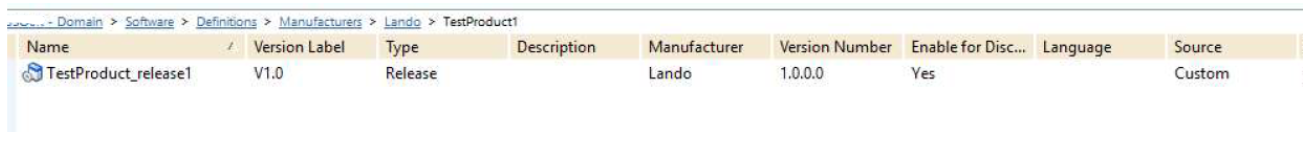

Having a Test release created under a product as follow:

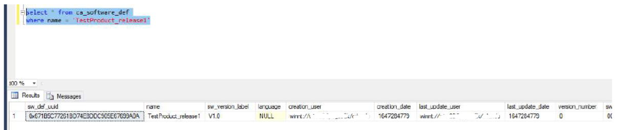

Searching this product release on "ca_software_def" table results in:

NOTE2: The 'primary_sw_def_uuid' is the ID of the "Product" that manages this release, which on this example is called 'Test_Product1', as seen on first screenshot.

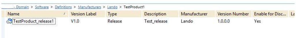

After this, the release was actually deleted and is not found on DSM Explorer anymore:
Finally, a new Release can be created with the name of the just deleted item:
