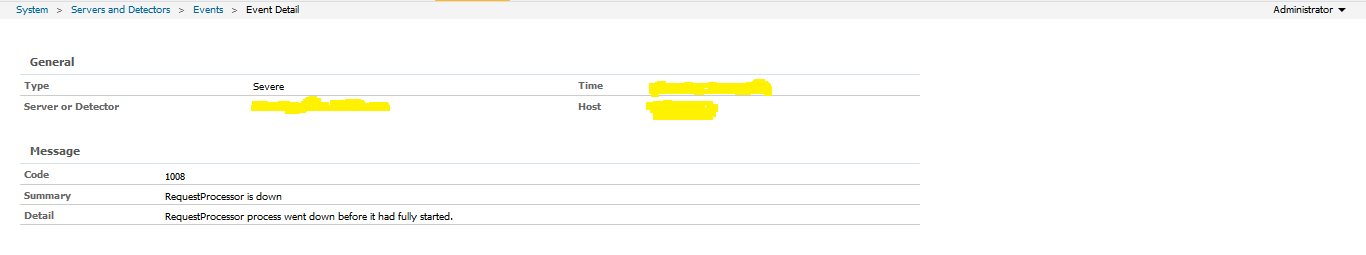

Network Prevent for Email server stuck in starting state on Enforce console, RequestProcessor status is stopped.
Tried starting it stops again and we can see event code 1008 on Enforce console > events:
