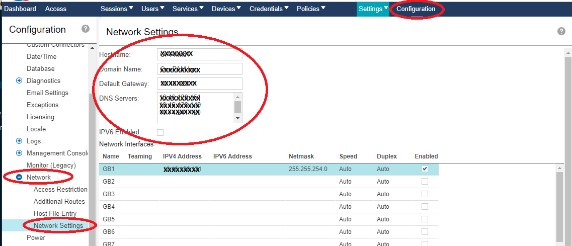

Required - All network and DNS settings should be set

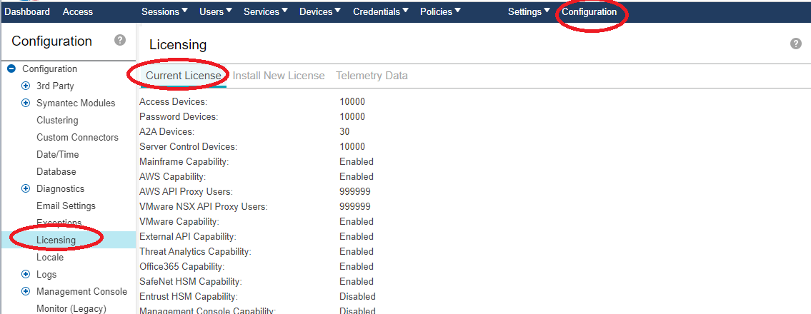

Required - Add and confirm all licensing is set and matches the license defined in the existing cluster

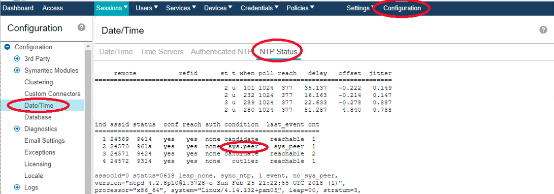

Required - Ensure NTP is configured and working, (look for the condition sys.peer)

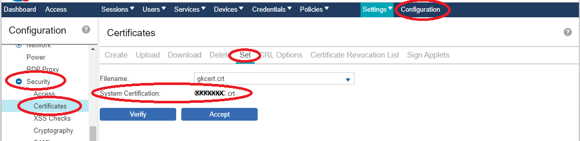

Required - Add and confirm the cluster certificate is set. (Depending on your exact configuration you may need to update all nodes in the cluster with a certificate that includes this new node in the SANS configuration)

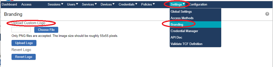

Required - Upload any custom Branding Logo

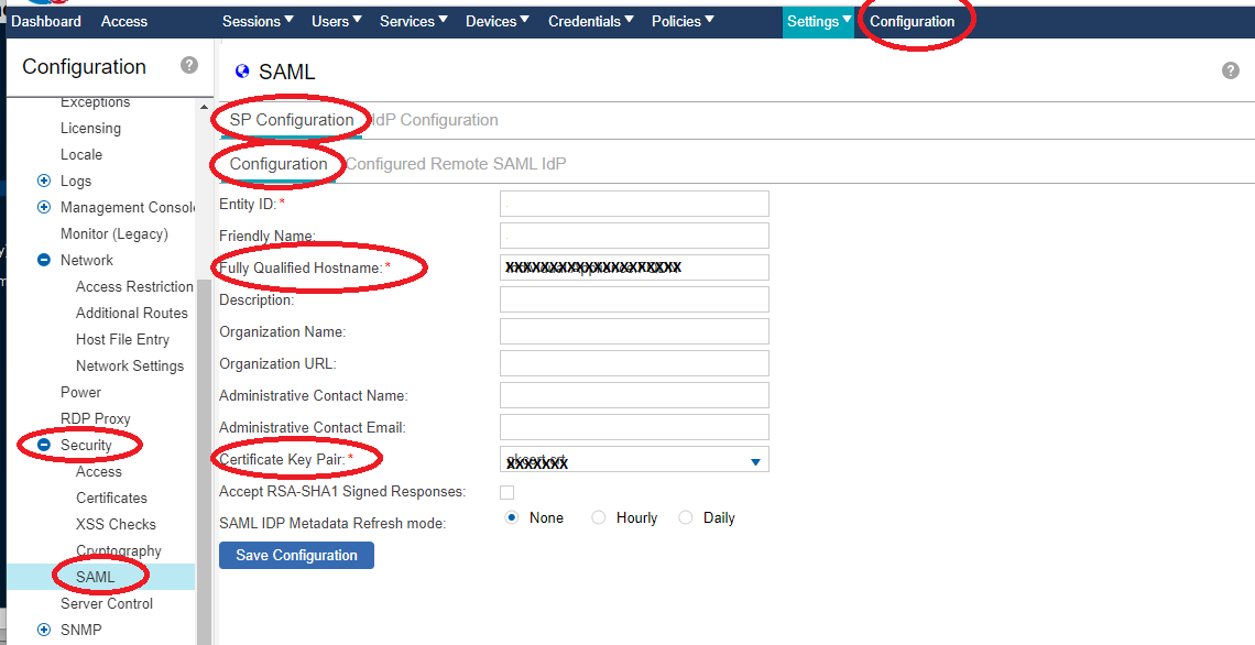

Required - If using SAML for authentication Ensure at least the "Fully Qualified Hostname" and the "Certificate Key Pair" are set

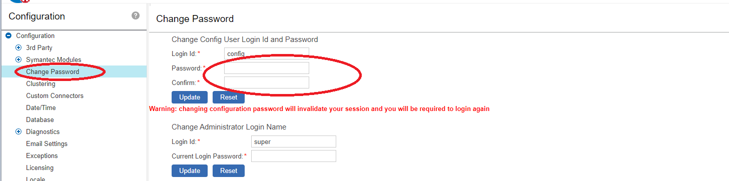

Recommended - While you can change the config user password after the node is added to the cluster it is suggested you ensure it is changed before adding to the cluster. Note after adding a new appliance to the cluster the super password is overwritten by the cluster, the config user password is not updated when adding to the cluster.
