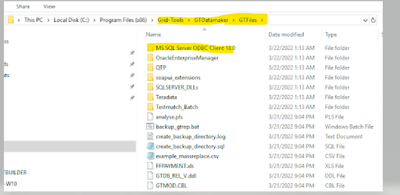

With TDM Datamaker patch 4.9.1040.0 or newer (for TDM 4.9.1) and 4.10.1001.0 or newer (for TDM 4.10), Broadcom now provides an updated MS SQL Server driver to version 18 which will allow for the connection to new database servers including those set up with encryption. By default, Broadcom only ships the ODBC 18 driver installer as part of the GT Datamaker installation. We do not install the driver for you. You will need to install the driver manually.
The updated MS SQL Server ODBC Client 18.0 driver installation can be found in the C:\Program Files (x86)\Grid-Tools\GTDatamaker\GTFiles\MS SQL Server ODBC Client 18.0 folder (default location). However, if you installed your GT Datamaker in a different location, you will need to look in the directory where GT Datamaker was installed.
As previously noted, you will need to run this installation manually.
Then create a new ODBC connection using the MS SQL Server ODBC Client 18.0 driver. Update Datamaker to use the new 32-bit ODBC connection name.
