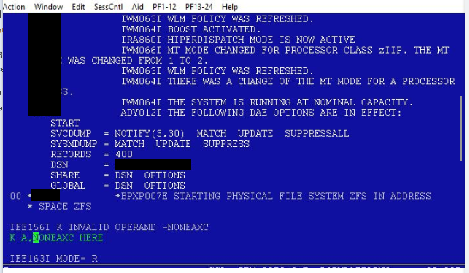

AP MCS session console hangs on message IEE156I K INVALID OPERAND -NONEAXC. When this occurs, the only way to restart the console and clear the error is to pause the session, clear the command area, and then restart the session. This can result in automation being missed.
Example of a hung console:
This issue is most likely caused by insufficient wait time being specified between two commands issued from the default MCS.SCR script file associated with the session definition. This in turn causes the two commands to become concatenated before they are issued resulting in an invalid command.
Here is the code section from the MCS.SCR script file causing the error:
Notice that when the two commands shown in red above are concatenated, this results in the invalid command "K A,NONEAXC HERE" being issued as shown in the earlier example, and that in turn causes the hang. The one second wait time between the two commands is insufficient which causes the concatenation of the commands.

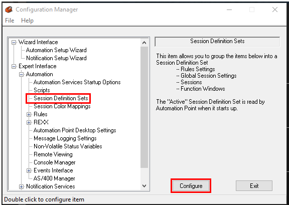

1. Open the AP Configuration Manager.
2. Expand the Automation tab:
3. Click on "Session Definition Sets" and then the "Configure" button:

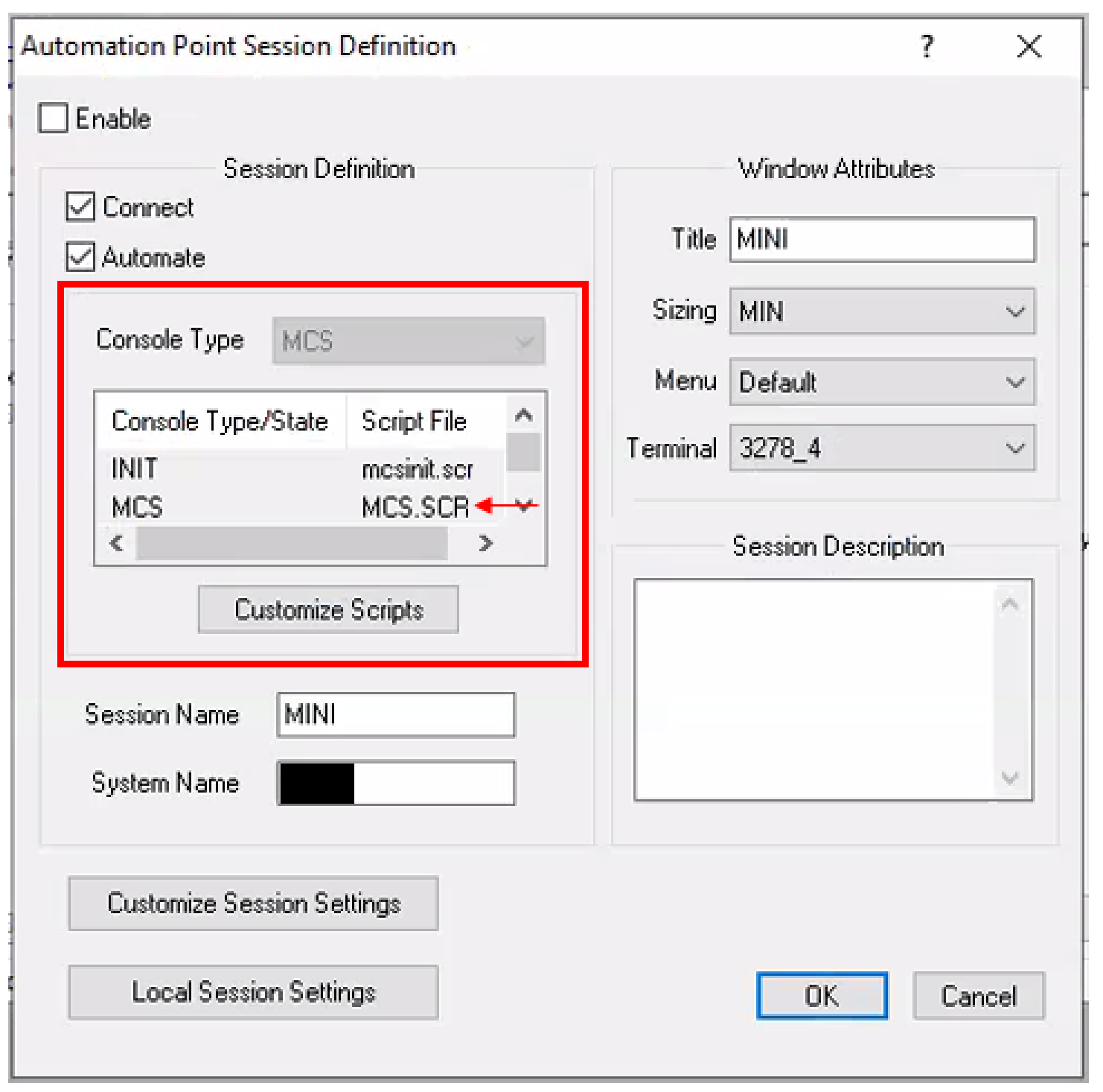

4. Double click on the appropriate session definition entry under "Sessions" on the resulting page. The session definition will appear, click the "Customize Scripts" button:

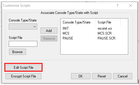

5. Click the "Edit Script File" button:

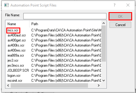

6. Locate the "mcs.scr" entry in the list and click on it, then click "OK":
