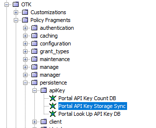

The Encapsulated assertions got corrupted during portal enrollment.
  1. We saw the Application API Keys are not synced from Portal. All others are in sync.
  2. Reviewed in Policy Manager,  and found corrupted assertion "Portal API Key Storage Sync" in policyfragments/persitence/apikey folder.
  3. Looks like a policy fragment instead encapsulated assertion (the icon does not belong to the encapsulated assertion, missing the green star icon).
  4. Confirmed from the policy manager that several other encapsulated assertions were missing from policy (Portal lookup Api key DB, Portal lookup Api key NOSql missing both).
  5. From the policy manager, view Manage Encapsulated Assertions
    • Deleted the following:
    • Portal API Key Storage Sync
    • Portal lookup Api key DB
    • Portal lookup Api key NOSql
  6. From a working Gateway server, export the same encapsulated assertion and import it to the problematic gateway.
  7. From the problematic gateway, Policy Manager, go to Tasks-> Extension and Add-Ons -> "Manage Encapsulated Assertions"  and import the file you exported before "Portal API Key Storage Sync".
  8. Once imported, check if it appears under the services window, if the icon does not shows like a green star, import again and overwrite it until you see the icon for encapsulated assertion.
  9. Restart the gateway services.
