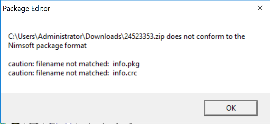

Errors when upgrading to OC v20.4 – Cumulative Update 1 (CU1)
.zip file does not conform to the Nimsoft package format.
Caution: filename not matched: info.pkg
Caution: filename not matched: info.crc

  • Error occurs when trying to Import the consolidated nested zip file into the archive without extracting the contents first
  • customer support portal navigation
When trying to upgrade to Operator Console 20.4 – Cumulative Update 1, some customers are encountering a package format error message when trying to deploy the cumulative update package:
To avoid this issue, follow this process.
When you are on the Downloads page, select all of the packages by clicking the checkboxes.
Then click “Download Selected” at the TOP right-hand side of the page.
Note that when you click the button on the top right side of the customer portal page and choose “Download Selected," the downloaded package, (in this case the file name was 24520125.zip for instance), is a true zip file that contains other nested zip files. It is NOT a Nimsoft package .zip.
Therefore, you MUST extract ALL of the packages first, before importing all of them into the Primary hub local archive via drag and drop or rt-click on the archive window and choose ‘Import.’

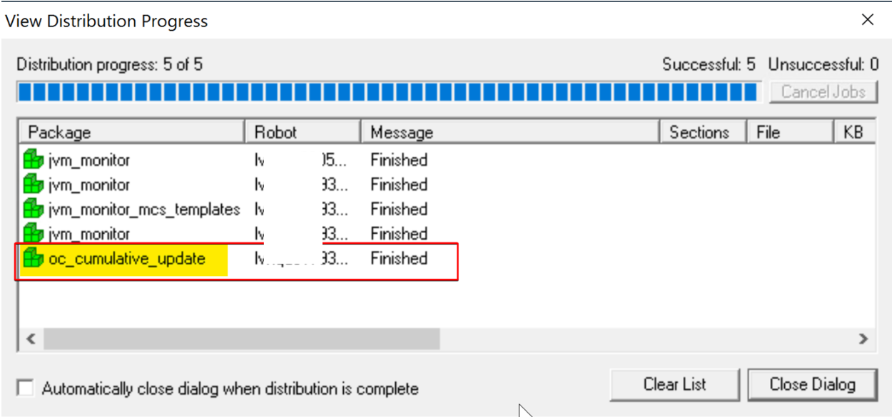

***Please also note that you should NOT have to deactivate the wasp on the OC Robot before running through the upgrade process***
Also, when deploying the oc_cumulative_update package to the OC robot, if the distribution window displays:
   "Installation of section webapp failed"
Cause: There may be 1 or more webapps installed that are interfering with the installation.
In one case, we found the error was caused by the presence of some old webapps related to DCIM/dcimportlet for the ecometer probe.
While wasp was up and running, once those packages were removed via accessing the controller probe utility, and choosing inst_pkg_remove to remove each dci* related package, the oc_cumulative_update deployment was then 100% successful.

Deploy the package oc_cumulative_update 20.41  (CU1) to the Operator Console robot using the web-based adminconsoleapp.
This will deploy all other packages (included in the cumulative patch) automatically to the robot.
Notes:
1. metapack_helper gets installed and helps in stopping/starting wasp. It gets auto-deleted once all the required webapps are deployed.
2. Deploying the package oc_cumulative_update from IM GUI is currently no longer supported and this is noted in the updated documentation.
3. You can also deploy the individual webapps to the Operator Console Robot.
IMPORTANT:
Deploying oc_cumulative_update (from the adminconsoleapp) should help to avoid the issue in IM when using distsrv, including avoiding the manual effort involved in lookup and deployment of each webapp.
Also it is the recommended way as it keeps a record of the patch level of the Operator Console.
