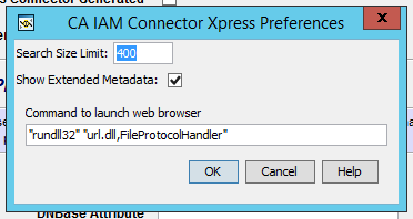

To confirm which provisioning attribute is assigned to your connector attribute, go to the Connector Xpress tools menu and select preferences.
Select "Show Extended Metadata" and click OK
Now if you review the Connector Attribute you will see there is an "extended properties" section that shows the "metadata" item name which corresponds with the provisioning attribute.

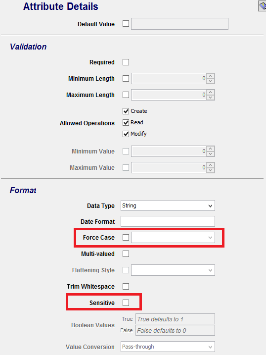

If you need to reference\ search user attributes irrespective of the case (ie "James" and\ or "james") then you need to set the "Force Case" option to "Preserve".
If you change this setting you will receive a notification that "This will change the provisioning attribute name".
If you revisit the extended attributes you will see that a new Metadata item Name has been assigned (For example "eTDYN-str-multi-i-01"). The attribute name will contain a "-i" which indicates the attribute is case-insensitive.
