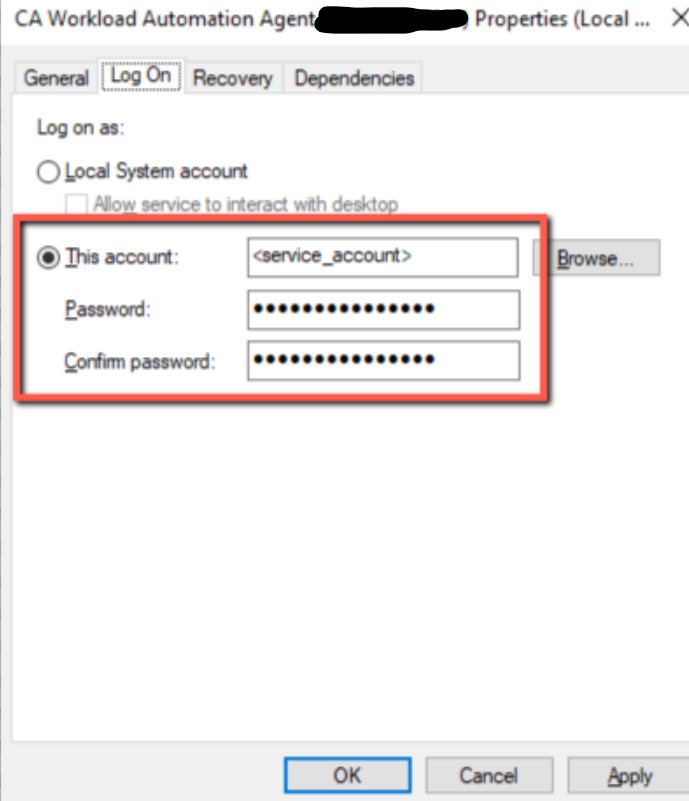

  • If the AutoSys service is running as the batch_operator1 user, then you will need to update the account password for the service to reflect the new password. The same applies if you are running agent as this service account. Failure to do so will result in AutoSys failure to start. If you are using Local System account, then no action is needed.
    Example:
