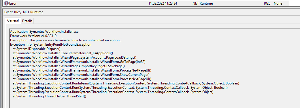

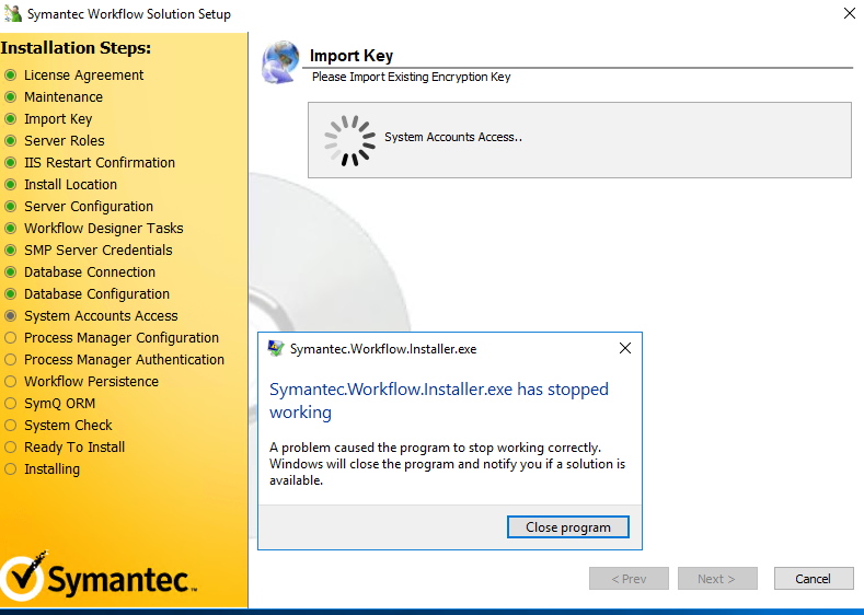

During the upgrade of the WorkFlow (WF) Server from 8.6 RU1 to 8.6 RU2, the Installer crashes at step "System Accounts Access" in the Symantec.Workflow.Installer.exe
In Windows Event Logs following events are logged:

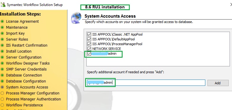

For Workflow 8.6 RU1 installation, I used windows credentials (currently logged in domain admin account which is also local admin "domain\admin".
Same domain admin account used for SQL Server connection (I manually added it in SQL logins) to access ProcessManager database
In WF 8.6 RU1 installer on the accounts page, I added "corp\myadmin"
Workflow 8.6 RU1 installation successfully completed as well as Service Desk 8.6 installation.
3. Downloaded workflow 8.6 RU2 installer and then it crashes on accounts step

Known issue. We simplified usage of IIS Web Manager API.
A fix is already included in our ITMS 8.6 RU3 release.
NOTE: One user was unable to get this to work so they set the "Symantec Workflow Server" to "Manual" start as they are not using Workflow Solution.
